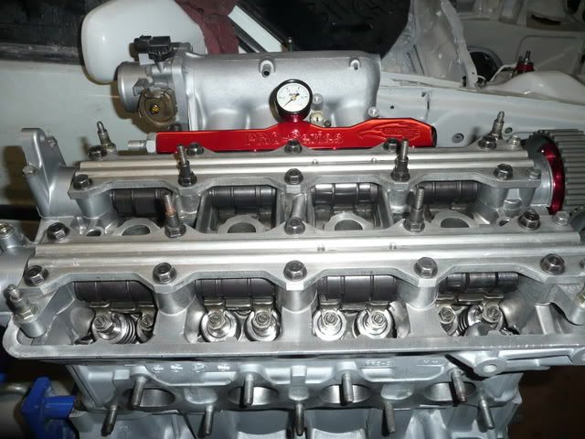

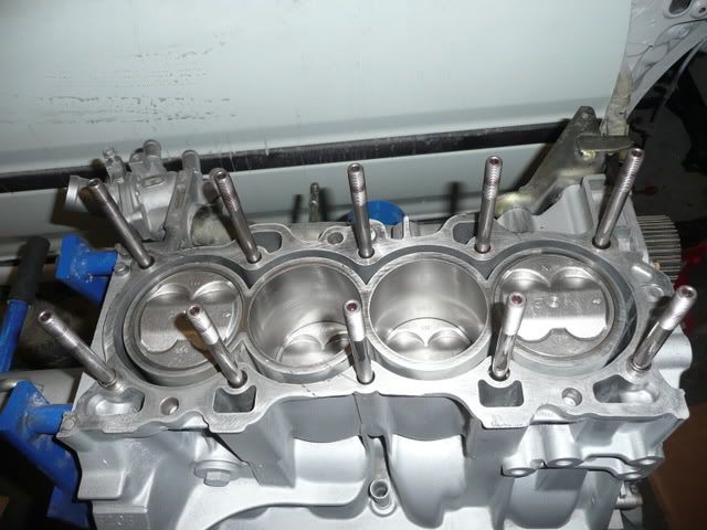

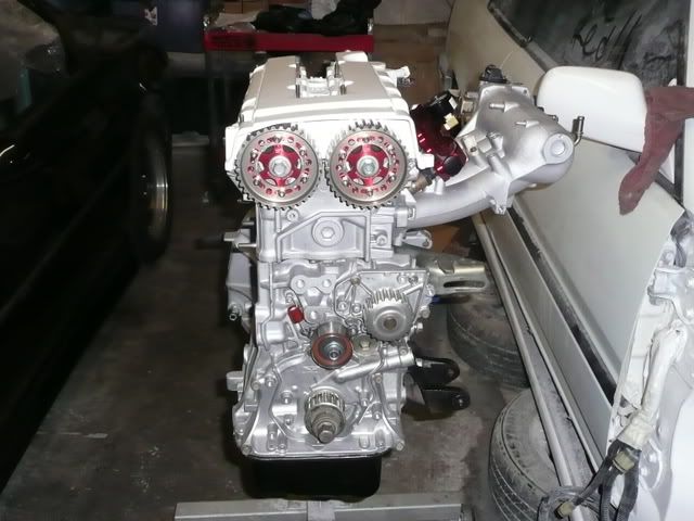

    i just finished my motor build and i wanted to know what trans to go with which is better for my build here is a run down of the build nothing to crazy just something better than stock
    b20b block
    rs machine pistons 84.5
    stock rods shootpeen
    stock crank
    arp rod bolts
    klevit bearings
    type r water pump oil pump timing belt
    clutch net stage2 6 puck clutch set up with aluminum fly wheel
    obd2 b16 head
    new oem valves and seals
    type r springs
    crower retainers
    stock b16 cams
    skunk 2 adjustable gears
    type r intake mani
    type r throttle body
    golden eagle fuel rail
    aem fpr
    all new oem gaskets
    hytech replica headers
    greddy sp2 exhaust
    rywire mil spec harness
    p28 ecu
    thats pretty much my build now i just need to know wat trans set up to go with any sugg. will be appreciated thanks. here are some pics of the build
